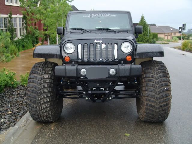

I want to change my Jeep TJ Wrangler to IFS.  What are good vehicles to look to for donor parts?  (the front diff must be able to take an arb)  I am thinking that a H3 front diff or Tacoma might be a good place to start.  The other big issue is what spindles to use.  I will fabricate my own a-arms.
Any advice?

To go faster in the desert.  The Jeep does fine in the rocks, but it needs help at speed.  Also I think it would ride better in JV over the big rocks with IFS.  All the OEM's have switched over for a reason.

Most IFS trucks can't go where my wrangler does without breaking.  Don't want to curse the jeep with likelyt ford based parts.  My suspension is already better than what most "prerunner" guys use.
I think I will be able to maintain more speed and ride quality over the giant boulders in JV with IFS.  Sledge is kind of bumpy.

Currently I have dual rate coilovers front and rear with airbumps.  Modified RE longarm with Poly Performance triangulated rear with truss.
It works very well, but it could always be better.

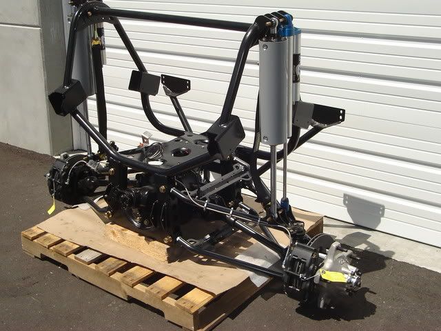

I have been working on a ISF 4x4 front for the go fast 4x4 guy for a long time. We have done are R&D on two Dakar race cars and worked well.

^^Hey Mojave, do you want to design one of those IFS for a 2000 Dodge Dakota?
Mojave Mojave
New User | Posts: 4 | Joined: 04/12
Posted: 04/29/12
08:05 PM
I can build one for any rig. What do you use the rig for?
